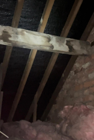

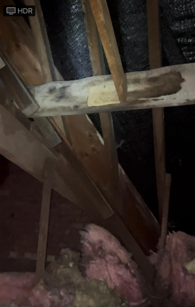

Agree.That would be mildew. You have an impermeable bitumen roof lining that will allow water to condense on it and drip onto the timbers. Increasing ventilation will help if you can, otherwise just clean it off if it is bothering you or might give a surveyor cause for concern.
