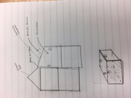

To paint the picture - I am about to put some insulation into the back half of the house, and in one area in particular which will in the near future become the main bathroom with a shiny new roof light so I can see (see diagram)
The roof here is a vaulted ceiling (irregular old rafters) running between the main A frame Oak beamed original roof in the front half of the house and the back wall, including a section of which is a dormer with a flat roof (and no ventilation I can see). There is breathable membrane on the vaulted/lean to section only.
A - Internal random rubble filled wall 1.5ft thick, up to 3/4 of the height is covered in clay and then old lime plaster
B - House back wall, a mix of rubble filled wall 1.5ft thick and concrete block in the dormer area. Gypsum plaster and plasterboard.
C - Will be a stud wall, construction to be decided
D - Party wall with next door, Random Rubble Filled Wall, 1.5ft Thick, up to 3/4 of the height is covered in clay and then old lime plaster on top.
