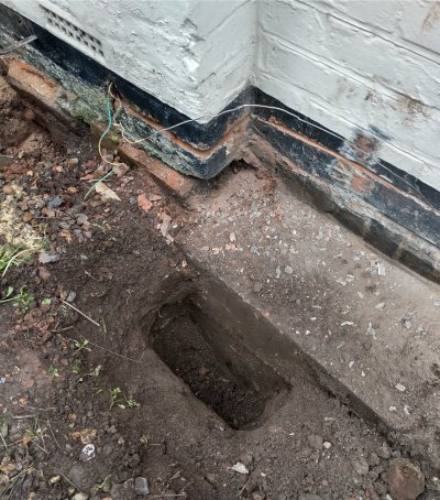

So, we dug some investigatory holes around the house:
This is the newest part of the house (apart from a first floor extension), with concrete footings:
This is the original house, which is just bricks straight onto the clay earth:

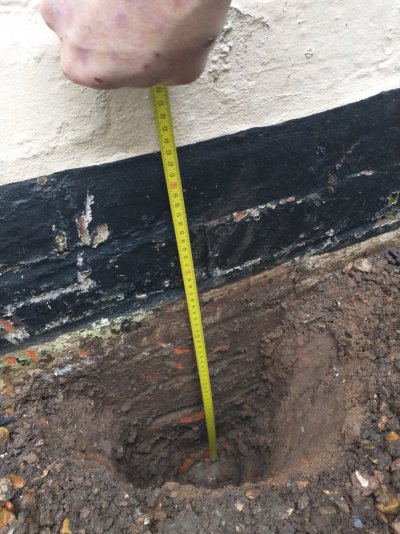

There are airbricks around the property, but no evidence of them inside. Measuring and comparing inside and outside shows that they are actually below the level of the current floor! No wonder it's all so damp!

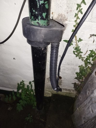

We discovered one source of the damp - my neighbours' downspout, which has a hose pointing straight into one of our airbricks!

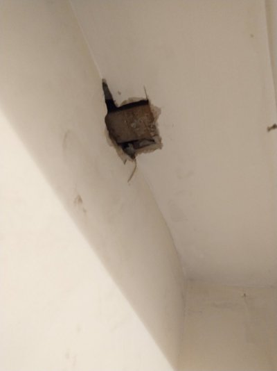

There is a boarded up... something in one of the rooms in the original part of the house, and we finally cut into it and it is an original beam, which is fantastic, but I'm still curious as to why it's been boarded up.
So, given all that we've found, the plan is to dig a trench around the outside down to below the rudimentary DPC on the original house and brace it with old slate tiles from the roof.
