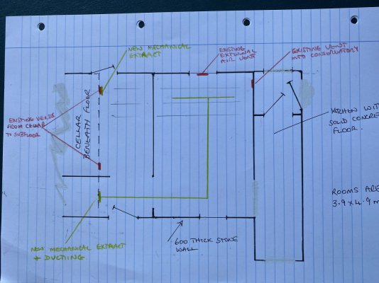

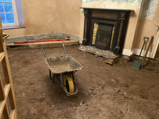

Thanks to everyone for your advice on my initial post, I have got out all the rubble from under the joists and I am left with the room as in the pic, I am looking to put a dwarf wall of a single concrete block on a 150mm footing with a 25mm wall plate on top down the left hand wall and opposite along the fireplace wall with a sleeper wall in the centre of the room and use 47 x 125 treated C24 timber joists at 400mm centres, which will have a minimum of 150mm air gap below.
Any thoughts on the ventilation system I am looking at trying would be greatly appreciated as this is my first time at this and I would like to get it right first time.
Thanks in advance, Dave
