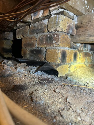

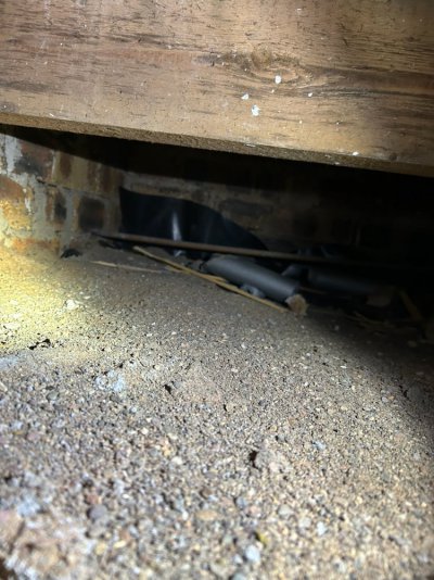

On lifting floor boards I have found plastic membrane with oversite concrete throughout, with sweating / water droplets visible on the underside of some of the membrane. I’ve had a couple of surveyors look at it and I’m getting conflicting advice. One is saying leave as is as it prevents any vegetation growth under the floor; whilst the other advises to remove both oversite concrete and membrane to allow evaporation from the ground. I can see benefit of both views but not sure which is best for protecting property and would welcome the experience and views of forum member who have had similar decisions to make. Thanks.
