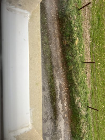

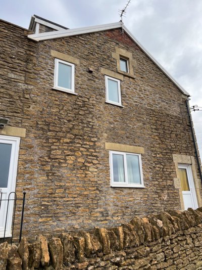

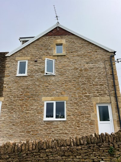

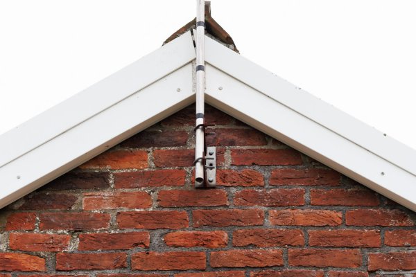

I've been trying to get my head around where the rain is getting in to my gable end wall. We sit on an exposed ridge-line in the Mendips, so frequently get blown horizontal rain. When we moved in the gable end looked like this and we were getting a lot of damp in the bathroom around the windows, especially after heavy rain.

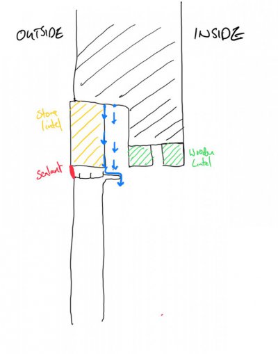

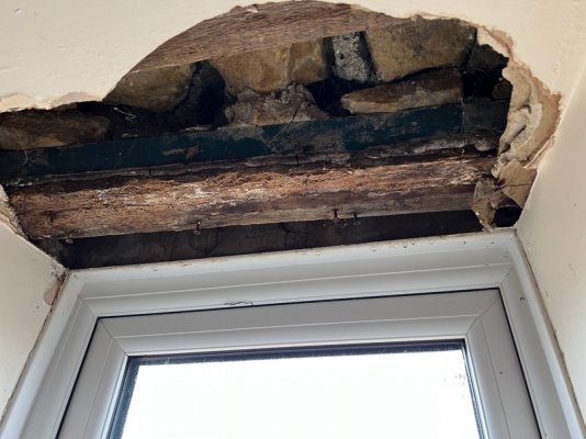

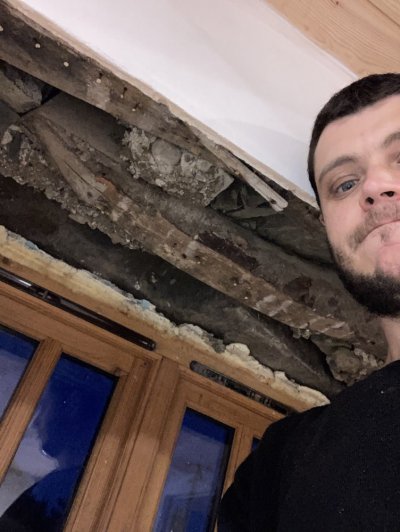

I hacked away some of the plasterboard around the reveals and found a void with sodden insulation in it. Removed it all and observed for a few months. In heavy rain with a SW wind (wall is SW facing) water would drip down the face of the lintel and onto the tiled surface below. I tried to put together a drawing at the time for my builder.

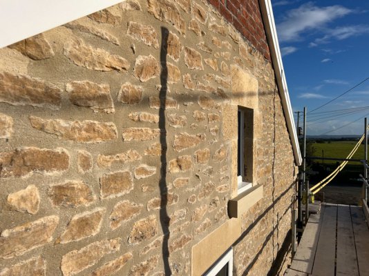

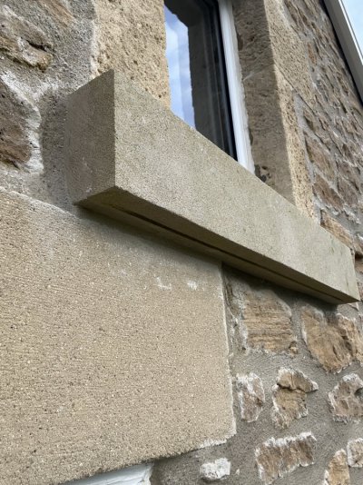

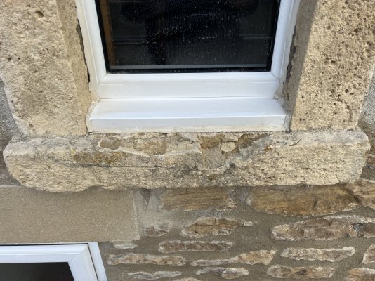

The sills of the loft window needed replacing, which I suspected could have been letting some water in. The pointing also wasn't in great condition (the front was pointed in cement and starting to cause the usual issues). Got the builder in to replace the damaged sills and repoint the gable end and front in NHL 3.5. Work was completed in October. They also skimmed back over the hole in the bathroom (with Gypsum).

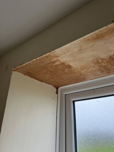

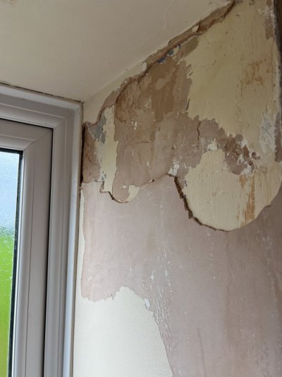

Fast forward 4 months and the wall is definitely drier, and dries out more quickly. However, on three occasions (which is less than before!), we have had the same damp spots coming into the bathroom. Always during torrential SW driven rain.

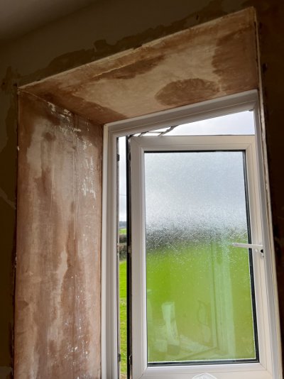

I initially thought it might be the wall getting saturated, but as part of a wider bathroom renovation, I've stripped the other window (which I have discovered has gypsum skimmed over paint, over more gypsum and some kind of cement underneath!).

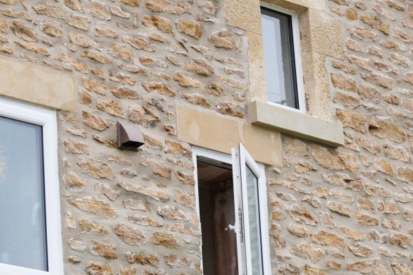

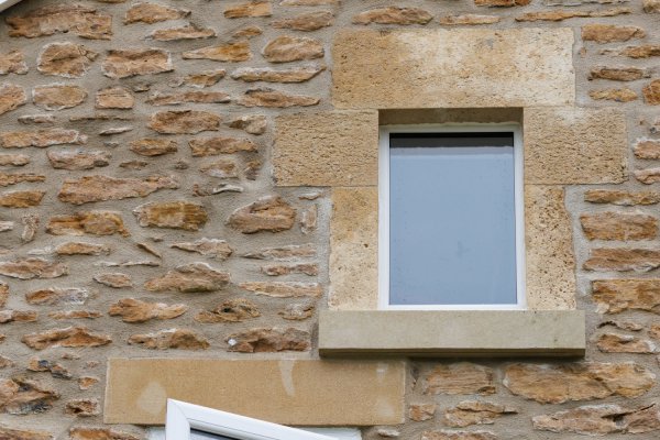

Whilst one corner has been getting a little damp, the other is completely dry, so I can't think that the wall itself is saturated as surely it would cause wider damp issues? Any ideas for a next step would be great appreciated. I'll finish with a few photos taken this morning of the exterior. We had 41mm of rain last night and extensive damp in the usual spots. The worst area for ingress is the top right of the open window as viewed from outside.
