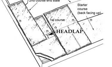

I'm having a slate roof phase at the moment! I'm learning a lot, but this has stumped me. I was chatting to my father who mentioned that on the slate roof they had replaced about 15 years ago, the starter course wasn't installed with enough overhang to effectively drip into the gutter. Why he didn't sort this out back then i don't know!? but i've found myself trying to find out if there's a way to replace or extend the starter course without ripping up the whole roof? All i can think...is possibly taking up the second line using a slate removing tool, then removing and replacing the starter course before re fixing the second line with hooks?...I'm sure someone out there will have an obviously better solution?
