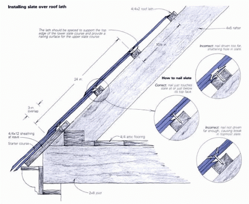

That's a really useful document. I've saved it to my "Useful Building Stuff" folder.jungle_jim01 said:I've just come across this document:
http://www.nordskiffer.com/kataloger/Fixing.PDF
chp 7 indicates appropriate headlap in relation to slate dimensions and pitch which looks really useful. So i should get away with 21 degree roof as long as the slate size and headlap are right.
