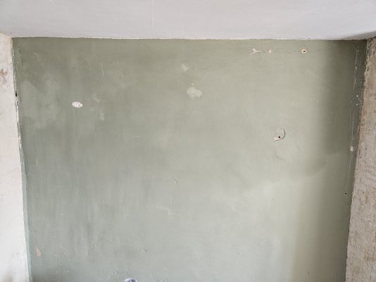

One wall in particular has always been quite damp (wall in green) - I assumed this would improve with the external render, however I am guessing that the wall is still deeply damp so could do with stripping away and re-finishing in a lime base coat with a finishing lime skim

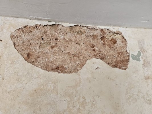

The other walls have very loose finish in places, so I have begun to remove the really loose bits to see what is underneath. At first glance I assumed gypsum basecoat with a gypsum finish, however doing the vinegar test just now the basecoat seemed to fizz a lot whilst the top coat produced a few bubbles. Could it be that the base coat here is lime, and the top coat is gypsum? The basecoat seems to have hair in it, which is a good indication of lime I guess?
I want to give repairing and finishing a go, and have been reading up on lime. My first thought was to remove everything, and look to re-plaster using appropriate lime, however I am unsure now as if it has a good base of lime it might be worth patch repairing with lime again and then putting the appropriate lime skim over that?
