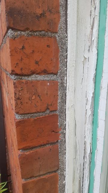

I have just installed my new sash frames but I have some considerable gaps around the outside between the frames and the brickwork, picture below showing the worst.
My original plan, before fitting, was to caulk around and paint the caulk. But this is too much to caulk really. Im now thinking about pointing the gap. My only concern with doing this is that it wont seal the gap and seperate the wood from the potentially wet brickwork.
Now the house is cavity hard red brick construction so im using cement. The paint on the windows is waterbased so linseed based mastics are a no go.
Any help appreciated. Thanks, Craig
