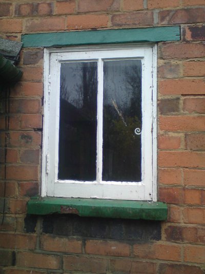

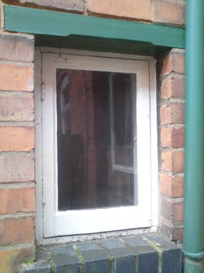

I have another window question. In my kitchen/scullery I have a larder with a small casement, and in the main room, a large sash and a slightly larger casement on the back wall next to the chimney breast. The sash and larder casement are set back from the face of the outside wall by a 1/2 brick, ie around 4 1/4 inches, and the larder casement is definitely original. However the rear casement is flush with the wall. I believe the rear casement has the original opening casement which contains the glass as it is nicely made and has rolled or at least wobbly glass in it, but i am certain that the fixed frame is not original as it is of vary scrappy construction (the stops are just scotia beads nailed badly on and the architrave around the edge doesn't match with anywhere else). Also the blue bricks which would have made a cill are also flush with the wall, a wooden cill has been inserted and it is all clagged up with cement. I wish to remake the fixed frame, but I do not know whether I should make it flush with the wall or set back by 1/2 brick like all other windows. When the windows are set back from the outside, there is no cill on the inside, and I imagine in a kitchen/scullery it would be useful to have a cill inside to put things on but I am more interested in getting it correct. Does anyone have experience or knowledge of the conventions of windows in a scullery???
Here are some pics
Here are some pics
