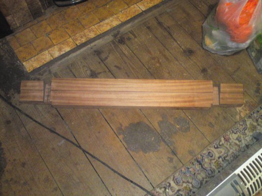

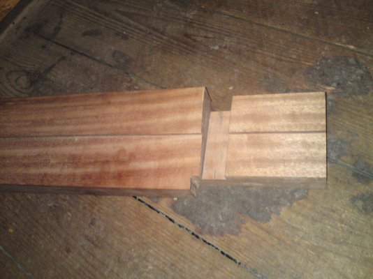

Hello all. Over the next 3 days I am hoping to make a sash window box to replace the rotten one at the back of my house, so it can coincide with some building work. I am re using the sashes, but will remake all but the top of the box frame. I have an old joinery book which states that play should be at least 1/16", (around 1.6 mm in new money). This seems quite close. Does anyone have any experience of this??? I suppose I can always make to size, or with minimal clearance and then plane the sashes to fit, it would be awful to make the box frame too large!!!
