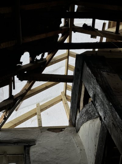

![IMG_3248.jpeg IMG_3248.jpeg](https://www.periodproperty.co.uk/forum/data/attachments/9/9635-1b431a7b449e8acf27b2c7201d75c6e8.jpg)
