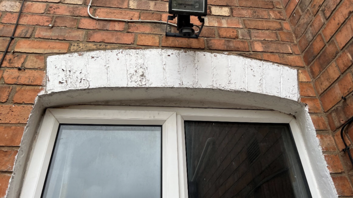

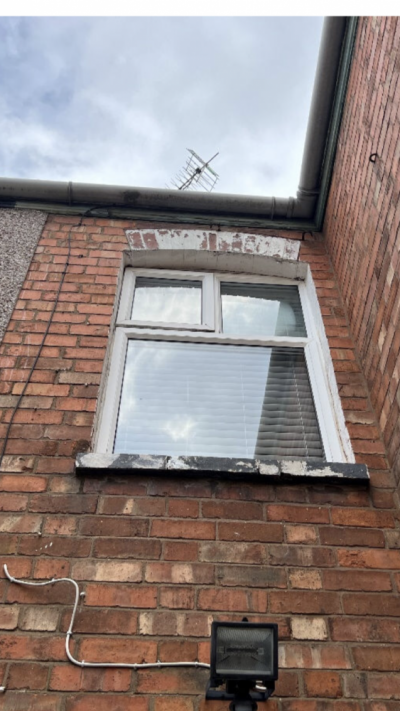

I *think* I urgently need to add lintels and replace 2 windows on the basis that my homebuyers survey said lintels were missing, no evidence of subsidence, just settlement and the windows are old PVC that do not conform to building regs. But, being new to this, I have no idea who to call to fit lintels and new windows (which I gather requires Building Control/FENSA approval?) and I was wondering if someone could offer any advice please?

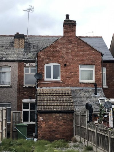

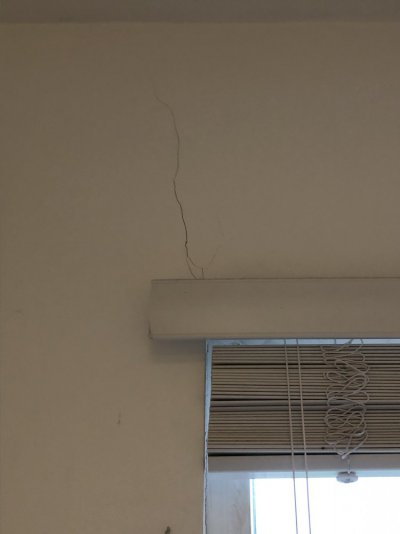

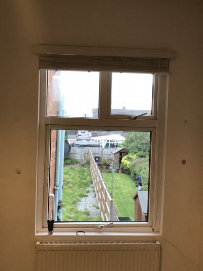

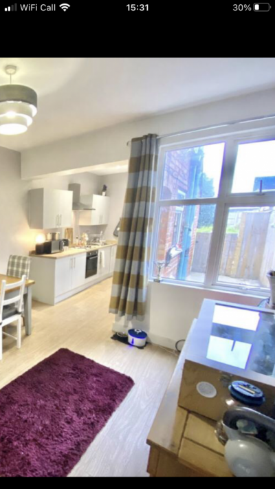

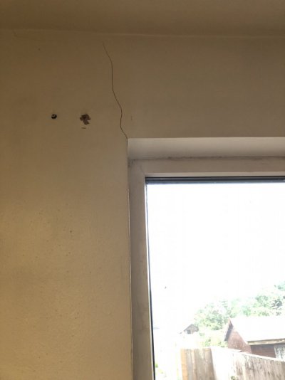

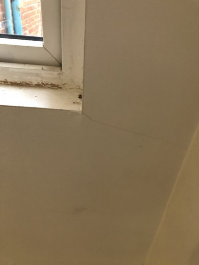

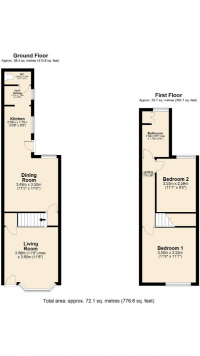

For background, (in case it might not just be lintels?!) the issue is significant inside cracks (over 30cm) from window corners on both upstairs and downstairs windows in one particular wall. The window upstairs sticks to the point that I opened it once, thought it felt like it was been compressed under weight and vowed never to open it again until replaced! As per floorplan it is the window in Bedroom 2 and the window below it in the dining room. Also possibly worth mentioning is that on the same wall, the dining room has been knocked through to the kitchen at some point but again has no building approval. Not sure if relevant but the bathroom has a significant sloping floor towards the side return, cause unknown.

2, Could it be that knocking through to the kitchen has weakened the wall and this is presenting as cracks around the windows? If so who do I call to check the support for where the wall was knocked through and should I be doing this before/after/at the same time as the windows/lintels?
