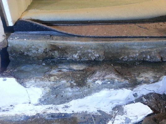

Existing concrete floor, no existing dpm visible although there is possibly a black bitumen layer under the concrete slab, seen on edge in photos below)), concrete looks to be about 100mm thick but I need to dig a trial hole in a corner some where!

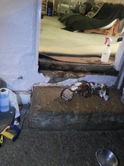

Also should mention our house is built into the hill and drops floor levels as shown in pictures:
Any thoughts/ previous experience would be appreciated.
