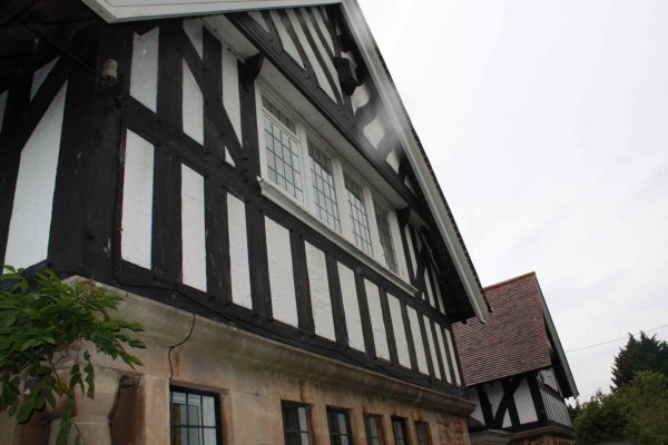

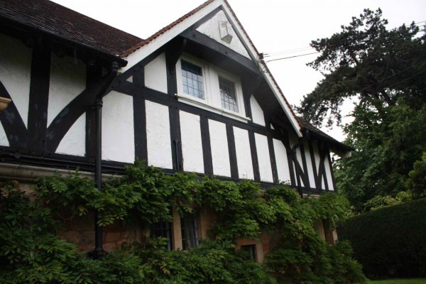

We live in an Arts and Crafts half timber framed building built by Walter Cave in 1898 in North Somerset.The wood is pitch-pine and the infills possibly local material/ stone, however there is lath and plaster on the inside of the gable ends from the attick??.
The outside is in need of repairs and decoration and we want to do this properly. I am a beginner at this sort of thing and if I get someone in to do it I want to know that I am not being sold a pup!!!

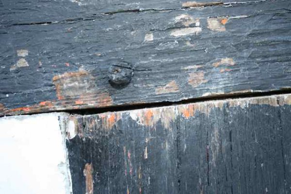

I have been on the ladder exposing the damage- photo shows few hours prodding and scraping.
As for the infills there are numerous defects along their edges which have previously been filled but are coming away- but in general they feel solid, but there are gaps on all 4 edges of almost every one. A small infill above the larger area of rot has been removed- it looks to be a concrete repair.
My questions are
1. Could the minor areas of rotten wood be treated with scraping away to solid wood, applying hardener and resin filling- or is scarfing in a better option (some of these are only about 4cm square) ?
2. What to do with the larger area of rotten wood?- any suggestions as the face is solid- its just the big hole behind.
3. Should I fill the timber shakes with linseed putty (does this come in black?)- I could do this myself- perhaps after a few coats of wood preservative?
4. The wood previously had gloss paint stripped from it 11 years ago, and was last coated with Jotun Demidekk on a Visir primer. Would it make sense to give a few coats of wood preservative, then visir and demidekk again or are there better products?
