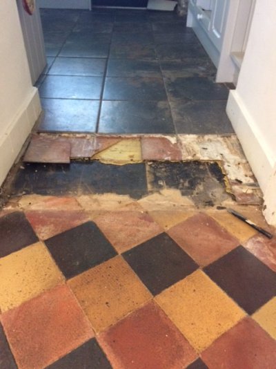

Pennyviz said:It is hard work but worth it I think ...

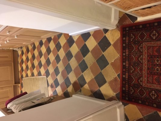

Feltwell said:Pennyviz said:It is hard work but worth it I think ...
OOoo - lovely!
I've got a not dissimilar floor, but without the black tiles. Did you regrout those, if so what with? Mine has fortunately only ever been covered up with carpet, so apart from the inevitable gripper rod damage and where some Neanderthal hacked a pipe across the floor - luckily next to the back door, so a door mat covers it - it's not too bad. It does need regrouting though, and the tiles are quite worn & grubby in places.
Pennyviz said:Thank you! Yes the brick acid trashed the grouting. Regrouted with 3.5 and fine soft sand if I remember correctly. Then sealed with ltp breathable sealer.
