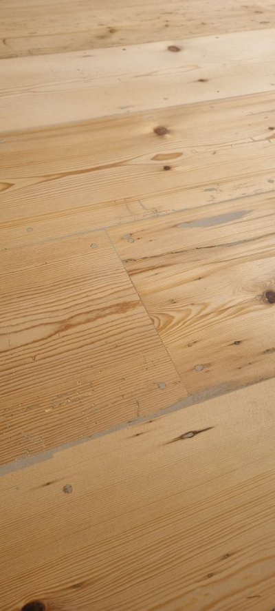

A photo for reference of our current master bedroom…
![IMG_3253.jpeg IMG_3253.jpeg](https://www.periodproperty.co.uk/forum/data/attachments/9/9616-a7b4bf6815d73b8a482e6ba6fe509654.jpg)
