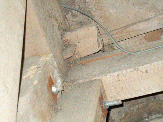

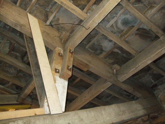

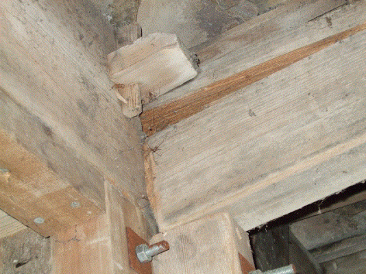

My stone built Victorian barn has a huge truss across its centre. Because the roof is made from limestone flags, varying from 2" thick at the bottom to 3/4" thick at the top, there are two purlins a side hanging off the truss. The way the purlins were fixed to the truss is that a hole about 2" deep and the width of a purlin was cut through the truss and the end of the purlin (cut down so it was the 2" deep) poked through the hole and fixed with a peg. The area where the purling sat against the truss was relieved by about 3/4", so the majority of the purlin's depth sat inside these steps.
The problem is that over the years the purlins have gone a bit banana shaped pulling the body of the purlin of the step, so leaving it hanging of the top 2" or so, so some of the purlins have split along their length at this point.
The problem is compounded by the trusses being sistered, so the hole in the truss is actually about 8" long by 2" deep in a 14" X 4" section of the truss in two places each side.
What I was thinking of doing was to have some proper steel joist hangers for the purlins. But to fill this hole with mild steel that is "glued" in to add a bit of strength back into the beam, seems OTT, but I doubt if a piece of wood could be made to fit any better. As the hole is towards the top of the truss, the "joint" would be in compression, so I suppose that could help. Looks don't matter. Any ideas?
