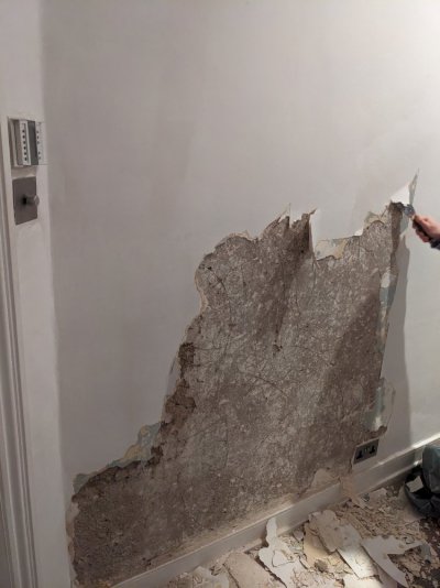

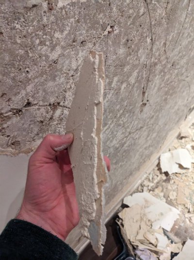

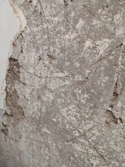

I started trying to remove some wallpaper and a gypsum skim coat started coming off. In some small areas the whole lime base coat has fallen off. Ideally I'd like to patch in new lime base coats where I have to, and re-skim the rest of the float coat with a lime finish. But I'm worried the key on the wall won't be sufficient to hold the top coats.
Is there a way people commonly "re key" old plaster? Do I just set into it with a drywall knife?
