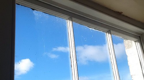

We have large ssh windows which do face south west and can therefore be 'in the weather'. Water drips in from the top homing bead and I cannot work out how it is getting there. We have had the front render on the house removed and all the stonework re pointed with lime. The window in question has had a new box frame and the window itself is sound. If the water is dripping from the top home bead, then water must be coming in above the window. I thought perhaps it was blowing up over the top sash, but that would not take it to drip from the home bead?
Around the top of the window frame are brick arches. I have presumed that the joints were made good when the pointing was done on the front of the house. ANy suggestions, is there a chance the bricks are porous or something obvious I have missed?
