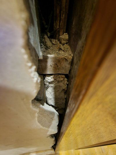

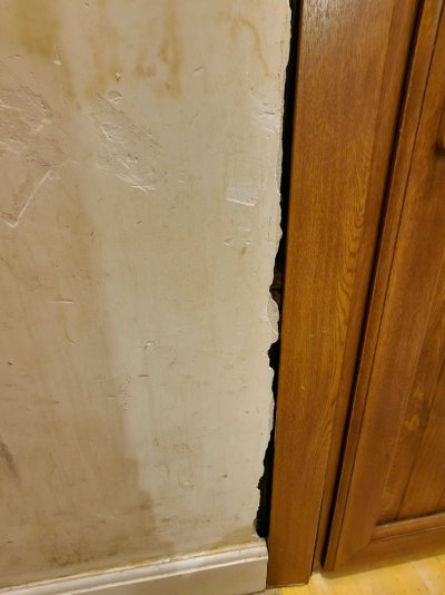

One of the best pieces of advice I got on another forum just after I bought my house was .."old houses are a compromise", sometimes living just gets in the waySo full disclosure... my initial thought was to use expanding foam as a first pass - but thought I'd seek the thoughts of the good people on here before rushing into it.
Reading between the lines, it sort of seems like it nobody would hugely blame me if I did - even if unable to bring themselves to publicly endorse it
Guess I'll have a think then - thanks a lot for all of the suggestions - much appreciated![]()
