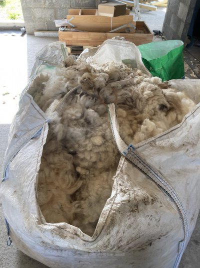

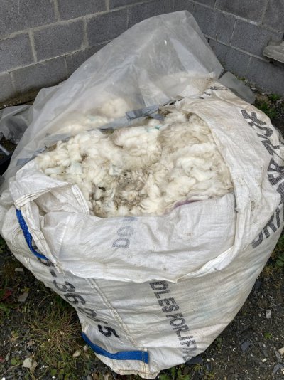

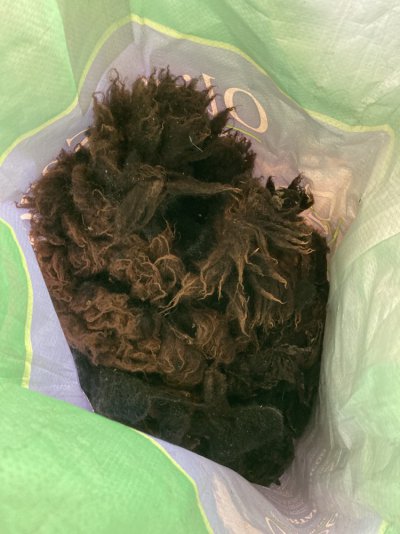

We started by picking up 3 huge builders bags full of dirty greasy fleece from 4 local farms / homesteads around our village. Total cost: 25 quid. We probably got about 60 sheeps fleeces for that price. Some black, some white, some ewe, some ram.
