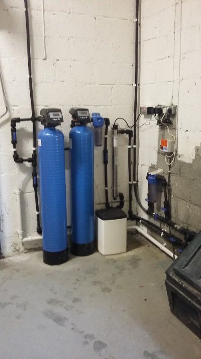

I fitted a low level well pump connected with a foot valve in the stream with a 20 micron filter to take out any lumps before it made it to the settlement tank.
On the left is a Filter-Ag which removes suspended solids and clears the turbidity and the water passes to the greensand filter to remove any iron and manganese. (The white container is the regenerant tank for the greensand filter which has potassium permanganate in it to recharge the greensand after back washing has taken place) After the greensand filter a sediment filter removes any medium which might be disturbed during the backwash operation and then an Ultra Violet light kills off bacteria. Before the treated water passed to the house I flushed the supply pipes with Milton Sterilising fluid to kill off any residual bacteria.
The well water supply to the tank is against the right hand wall with a sediment filter fitted to it.
The water is now crystal clear and tasteless. We will have it tested in a month’s time for bacteria to ensure all the treatment is working.
