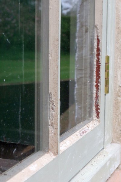

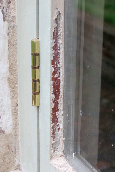

Linseed putty needs to be prevented from drying out. The usp with Bedec is that it 'breathes'. That will dry the putty, crack, fall out.
Linseed putty - oil or linseed paint.
For my next project I'll be trying that Hodgson's. No use to the blue tits.
