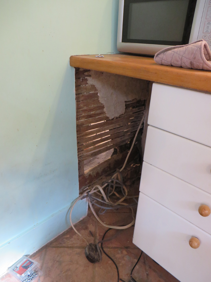

Just a thought - I've got a couple of smallish holes (around 40cm x 30cm each) at the bottom of a couple of lath and plaster panels (where the lovely PO had dispensed with any lath and filled these bits with long screws and nails supporting slabs of cement) and a patch on a wall that's just thick lining parer bridging another hole that all need filling.
I've got a bag of lime/hemp and some lime putty finish plaster but no laths - I was wondering if I bought and dismantled one of those garden expandable trellis panel thingies it'd make a suitable source of lath as a much cheaper solution to paying delivery on such a small quantity of 'real' plastering lath or a single woodwool board?
Reasonable idea, or penny pinching that I'll regret later...?
