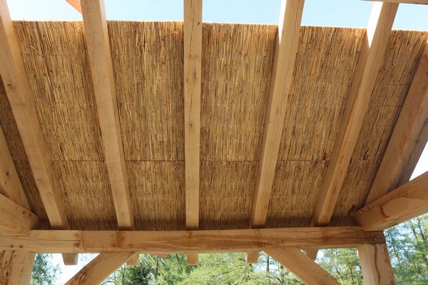

The question is: what to replace it with? I've been looking into Wood-Wool boards, Claytec boards, reed boards and of course Actual Lath and Plaster. The clay boards and reed boards look to be quite heavy and rigid for a ceiling, wood wool boards looked promising but I handled one today and it's a lot more rigid than I hoped ( in a cracking-round-the-outline kind of way) and the 15mm size I had my eye on doesn't seem to be specified for ceilings, from looking at the data sheet.
