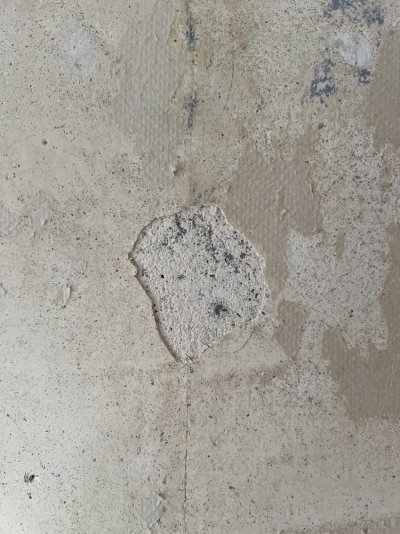

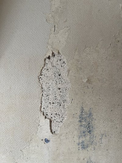

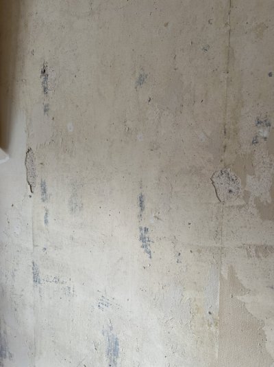

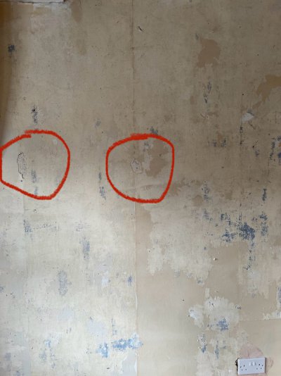

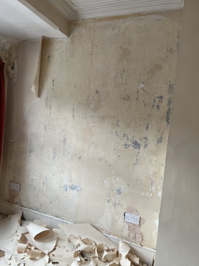

I’ve stripped back some of the wallpaper to the see the condition of the gypsum plaster underneath. I’ve knocked on it with my knuckles and it doesn’t sound hollow. I don’t think it’s blown at all.

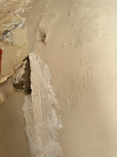

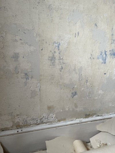

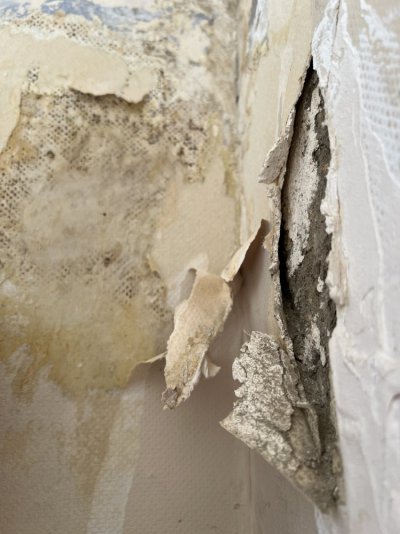

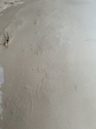

However, while stripping the wallpaper, it pulled off a bit of the plaster with it (quite superficial though) so there are small patches of this on the walls. I’ve attached photos if that’s helpful (some show the whole wall and then closer up of how far apart the patches are, another shows close-up of the patch to help you see it more closely).
Where there arent patches, the plaster feels very stable, not crumbly at all and pretty good condition in my inexperienced opinion.
I was originally going to get a plasterer to skim the walls and then I’d paint on it (I only want to use paint). My mum came round yesterday and she told me that last year in her 1990s house, she stripped her wallpaper back to plaster and she also had the same random small patches pull away with the wallpaper coming off. She advised not to bother with the skim plastering and to save the money instead for the future lime plastering work. She said she patched her bits up the following way: she sanded the patches down then used something like polyfila to fill them, then sanded it down again to smooth, then she put new wallpaper again (not paint). She likes to put up wallpaper and paints on that (I don’t know why), but she thinks it’s easier to do that. She also thinks I should sand down the entire walls a bit too.
Love my mum, but we are both inexperienced and we have two different houses. But now, i think maybe the condition of my plaster is not too bad? Or is it? As mentioned, it’s not blown which I’m confident about, but I don’t know if my mum’s patching up the loose bits will be good enough to make the plaster okay for paint and leave a decent finish. I’m not too bothered about perfectly smooth walls, but something decent has to work.
The other question I have is, how do I then prepare this old gypsum plaster for paint that had wallpaper on it since the 1970s?
