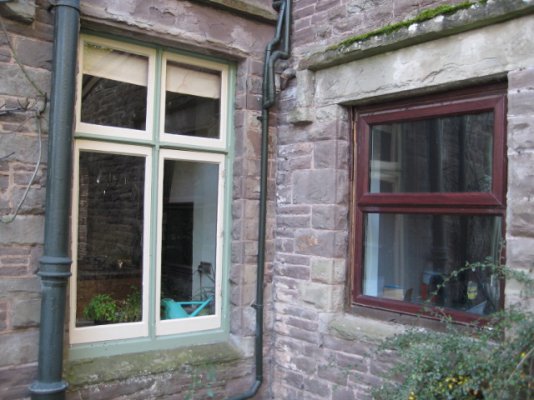

In my case it is more of an issue because the building is undergoing a change of use (pub to house) and the same regs require the whole thing to be upgraded to modern regs - make everything mouldy and rotten and replace the horrid drafty 100 year old windows with some nice UPVC
(I'm in a conservation area fortunately so can save the windows). There are caveats - they don't require anything that will damage the building, or will not achieve a 15 year payback.
