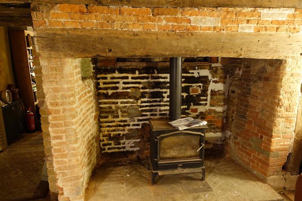

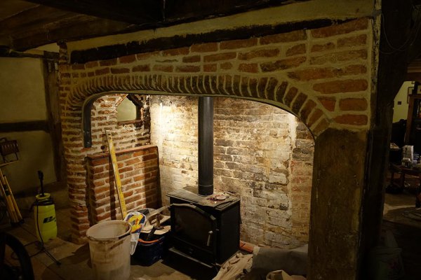

This is a follow up to my previous post "16c Fireplace - delicate renovation" end of last year. Progress has been slow due to various factors but we are now getting close to decoration.
We have repaired, rebuilt and re-pointed all of the brick pillars and fireplace surrounds using lime that could be recovered. This will all be left as natural brickwork.
However, the rear of both fireplaces are a complete mess of bricks from across the ages (+ mortar infill) and is not recoverable in my opinion. The bricks vary from small old clays to 1960s bricks in various layers.
I am therefore looking to paint over to create a more pleasing backdrop to the woodburner. I am intending to fill any obvious holes and clean bricks with Trisodium Phosphate to remove soot and other detritus. This will be followed by a coat of primer and likely topcoats a lightly coloured masonry paint.
Before I start would welcome any tips on best manufacturers products to use or alternatives or really any other comments on best way of doing this. The woodburner is sitting about a foot in from of this rear wall so assuming heat will not be a huge issue although I may get some sort of rear plate.

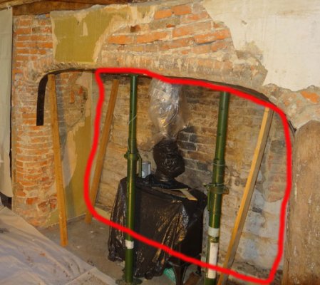

Have attached a picture that marks the area to be painted just in case it helps.
