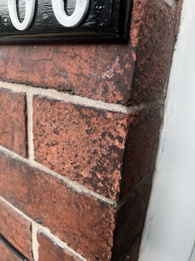

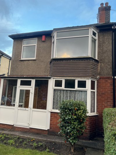

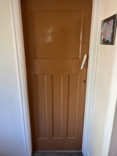

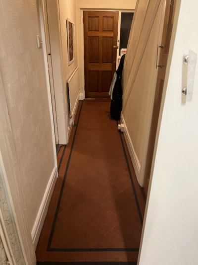

Thanks for your reply, we are fairly lucky, it has all the original doors, stairs and flooring, most in this area have had all of the character removed and replaced with modern materials so that they look like new build properties, not what we are going for at all, a few photos attached:The occasional brick was fired in a slightly cooler part of the kiln when it was made, so the face is a little softer than those around it and it's weathered more. Absolutely nothing to worry about, no need to do anything, just the lovely effect of age as Mardinor rightly says.

Good tip and well worthy of note.be aware that the panels are likely to be plywood. If they get too hot the glue may release and you will get bubbles as my late father found in his house also built in 1934.
