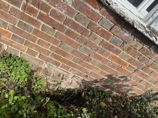

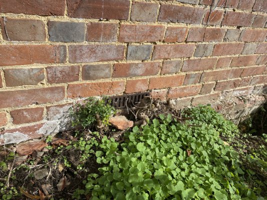

At the front, it looks as though there may have been a brick plinth, as the bricks at the bottom of the wall stick out slightly. My first assumption was that we need to take the soil away to show these two courses of brick.
The front wall and front door continue to the left of this photo. On the other side of the front door there are two old disintegrated air bricks that are a course above the plinth.

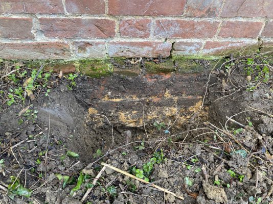

However, then I wondered if actually those are the footings and it might be a mistake to expose them. So we dug a trial hole and found that after three courses, it turns to stone and rubble. This is the hole freshly dug, and next is the hole after being washed by rain
From that it looks like the brick plinth is possibly footings for the wall….

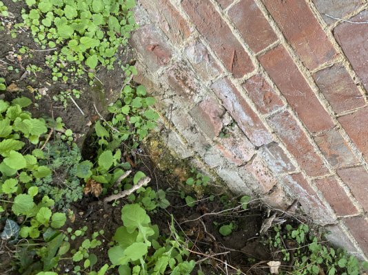

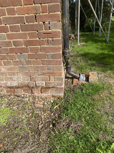

To complicate things further, if I follow the height around the side of the house, the top brick in the front “plinth” is about 5 bricks above the soil level - about 2/3metres from the corner, if I dig down about 5cm, I can see the start of brick footings just peeking through the soil.
It’s possible that the side wall was built at a later date l, but that would be strange as the bricks match on both walls.

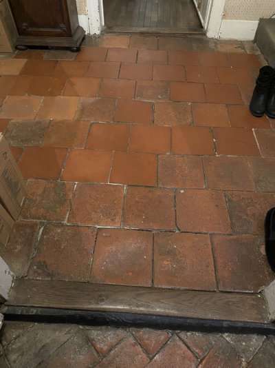

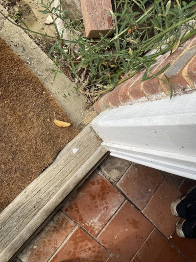

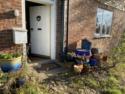

I’ve also added a photo of the ground levels inside and outside the front door. They’re pretty much the same, which makes me think the ground is too high. Once inside you step down slightly from the hall quarries to an old brick floor laid on bare earth. Pretty sure this is below the soil level outside.
The concrete slab that forms our front doorstep outside is at the same height as the top brick of the “plinth”.

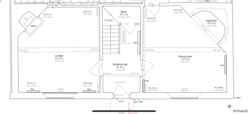

A couple more photos and rubbish diagram that might be helpful to get the idea.
