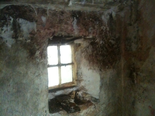

Here's a taste of the kind of damp that we had when first encountering the place -
