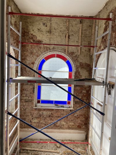

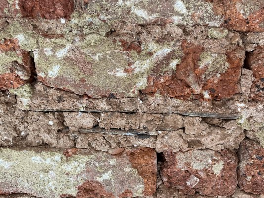

I’m getting bored of cement hacking now, only about a third left and then I’ll take the plasterboard ceiling down and see what lurks beneath. Something funny in the brickwork-I wondered if it was something to do with ventilation perhaps?? I’ll leave it alone obviously! Pic and progress pic attached
Looks like a repair job to me, gap too small for a brick, but too large to just be filled with mortar, so slates used instead to help pack it out and provide a bit more structure. I always keep a few old roof slates around when doing repairs for similar reasons. Great progress on the plaster, well done, and those windows are lovely!
Thanks twig! You could be right-it does look a bit narrow for a brick and mortar. I had to use bits of slate to help level a new brick I put in to replace rotten timber brick because the one below has deteriorated a bit. I didn’t really know if that was the right thing, but I could see it elsewhere so thought it might be . I’m itching to get the ceiling down now, but I have to be patient otherwise I’ll have loads of guff falling on my head
