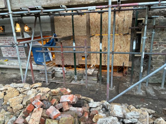

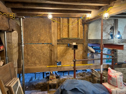

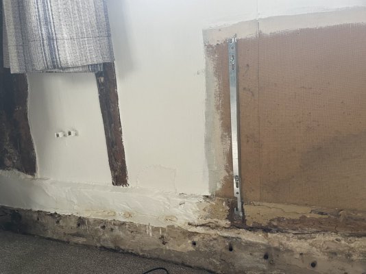

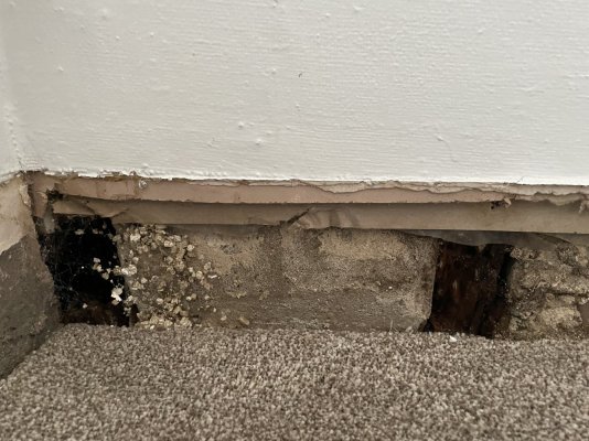

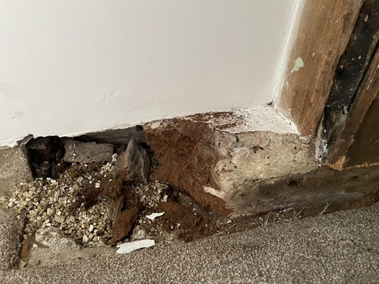

I have had a couple of floods in the house with water from a field opposite. Unfortunately insurance are only happy to pay for some repairs as they are saying there is underlying issues with the house. After removing skirting etc I have found concrete blocks in some walls. Some walls have a brick plinth and timber sole plate. One of which has had a concrete render and camp course put over it. It's only after removing the skirting etc this has become apparent. I am getting quotes from builders to support the house and build a new brick plinth and replace the sole plate in some areas but thought I would raise on here to see if anyone had seen similar or had any other ideas. Any help appreciated. I have attached some pictures. Also, this is a 16C Thatched Cottage.
