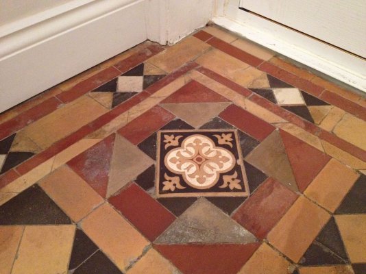

We are by now convinced that the smell originates from under the tiles, particularly from the section next to the front door, where the tiles have clear salt (or possibly mould) patches, as per pictures attached. At some point we laid an underlay, tightly taped to the skirting boards and with a plastic sheet on top (to try and insulate as much as possible). We left it in place for a couple of months in summer. When we took it off, the tiles in that section were wet. Proper wet, not just a bit damp. But curiously, they don't smell anything (and I have a very good sense of smell, which makes things worse). Some of the tiles sound hollow when you tap on them, but to be honest this seems to be randomly spread and is not confined to the section near the door. We have a cupboard under the stairs, which is also smelly. Not the same smell, not mouldy. It's the same cellar-y smell coming from under the floorboards as explained below.
