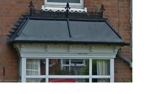

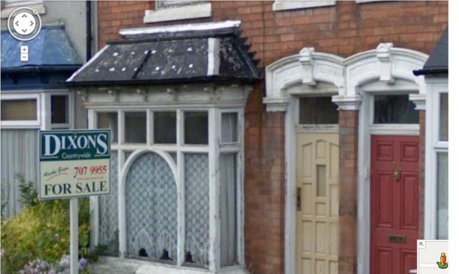

Hello. A few houses on my road have the original zinc (I think) roofs, but I have attached a picture of the only house in my street that has the original bay roof with cast ironwork above. I was wondering what the mopstick hip rolls are for, does anyone know? Looking carefully at the roofs it looks like the tubes are just soldered on and are not actually a join between two sheets as it would be with for example, a lead roof. I am thinking of replacing my very ropey metal roof with a slate one but with lead hip rolls and a lead top on the flat section. Does this sound like a good idea or should I reinstate the Zinc as in the photo??? I might be asking Doug for some help with this!!!!
