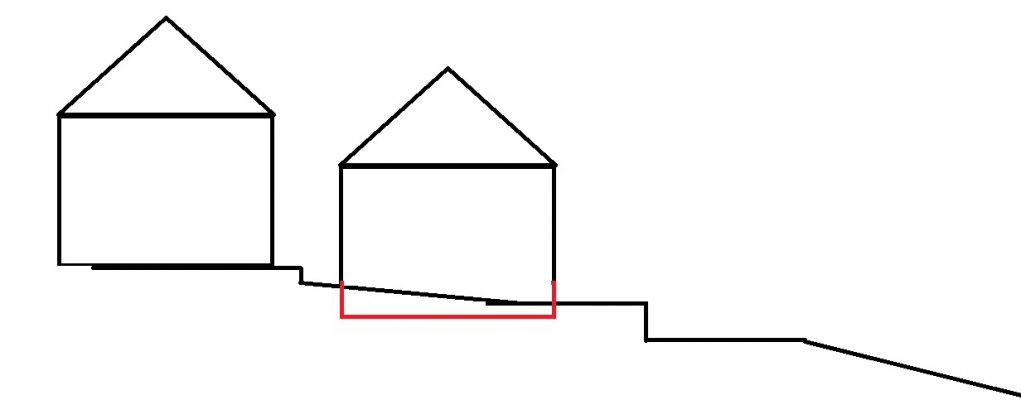

Hi All,
ok so next in my mind of the 50,000 jobs I have to do on this rennovation is to lower the ground levels which have been inexplicably raised all the way around the cottage. If I was being charitable I would say it was done to provice wheelchair access for this previously estate owned rented out property.
What I'm left with is concrete about 1 foot above floor level (and maybe more) as if the drain cover is anything to go by at the rear right hand side of the it's going to be about 2 - 3 feet.
So my hope / plan would be to break the concrete where it's been sloped up against the house at the front with just enough gap so that the water can run in. This would leave a trench approximately 8 - 12 inches wide and I suppose a foot deep... Obviously that will need to be filled with something but a conservation builder who came around advised not to put in a french drain as this just keeps the water in place....
So what's the best solution do you think ?
There's clearly been a problem as the dining room had the walls boarded, all the skirting boards were rotten, the dining room (again) has had a concrete over dpm installed (that's also coming out) and there's a lot of cement pointing which has to be removed too.
Lastly can I do any damage by removing the concrete ? or put another way is there ever a legitimate reason for doing it ?
I'll try and take / dig some pictures out.
Paul.
