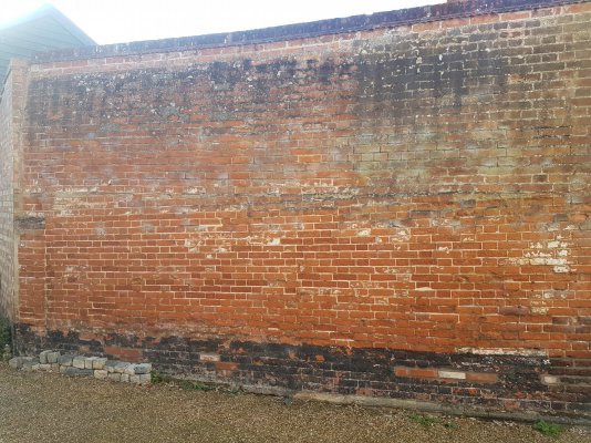

Secondly, is the back outside wall of the kitchen. It needs repointing, and I meant to to it this summer, but work got in the way.
It will need doing sooner rather than later. There's a lot of failing mortar and soft brick.
Ideally, I should use lime putty mortar, but I've left it too late in the year. How many weeks do you think we have left before it's too cold? 3?
I'm wondering if NHL 2 or 3.5 would be better, but as the bricks are old and soft, ideally it should be lime putty.
Any thoughts?
