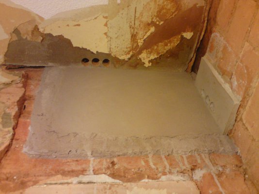

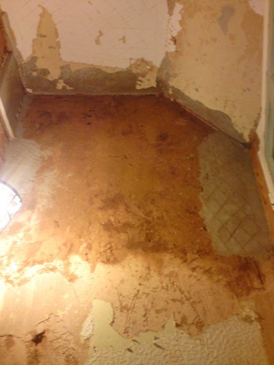

Hello all. I live in an early Edwardian terrace from 1904. Certainly a lot of walls need replastering as the plaster is either crumbling away or has come unstuck from the wall, especially around door frames and window frames. there are also places where the skim falls off with the wallpaper but the render behind is ok. I am convinced that the render although a kind of brick brown colour is lime as it fizzes in vinegar. However the skim (which is original) is much harder and more pink and I wonder if it may be gypsum.

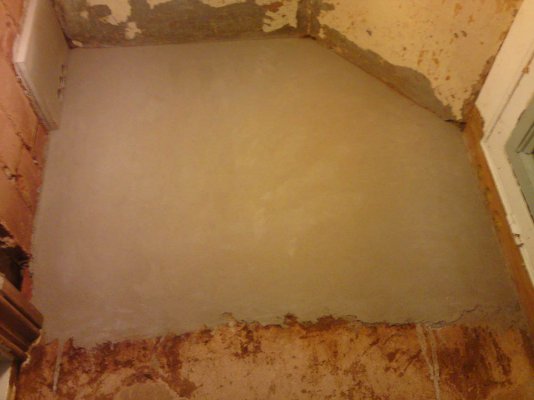

I tried my hand at lime plastering in a small area where I am putting pipes as I know it will be hard to plaster behind the pipes. I used Nhl 3.5 with sharp sand (2.5:1) for render to about 12mm. Then NHL 2 with fine sand (around 1to 1.5:1), for the skim. However, try as I might I couldn't get a smooth finish. It is flat and level but close up looks a bit grainy . I would like to get a smooth finish on the walls. What do people think of using gypsum over lime, or is there a finer aggregate that can be used in the top coat, like talc or something> Any advice would be very gratefully recieved.
