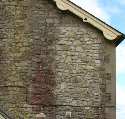

We are currently having a single storey extension built for our 1800s stone cottage. The external wall will be a cavity wall with a local sandstone facing to match the rest of the house.
I understand that the extension wall won't breathe in the same way as the rest of the house.
As the stone will match well with the rest of the house, we would like the mortar to as well if possible. The rest of the house looks like it has been pointed with lime.
Is it worth building the outer skin of the extension with lime mortar or cement mortar (if the builder can get a close enough match). Or would it make sense to build up the outer skin with a cement based mortar but point with a lime mortar (to match the rest of the house in appearance but also act as a sacrificial layer to prevent the stone spalling)?
Thanks in advance!
