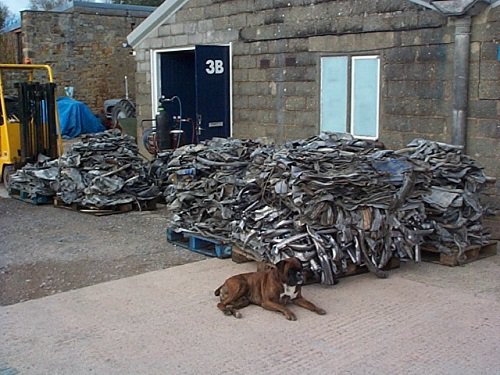

Had a really interesting day on Thursday: a few of us from the church were invited to the yard of our contractors (Norman & Underwood in Leicester) who are doing a lot of stone repairs/replacements on the church (thanks to our HLF grant). Apart from seeing the stonemasons at work on our stone, and having a go ourselves, we also saw lead sheet being cast (even though they are not doing our roof as it's not lead). This casting is done largely in the traditional manner on sand and N&U say that they are the only people in the country who still do it in this way; they can re-cast the lead from a particular roof and so send back essentially the same material as was removed from the roof, which pleases the heritage-minded.

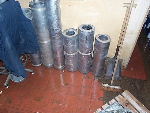

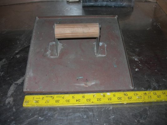

The casting process requires a sand bed being prepared which is about 6m x 1.4m and has to be done from scratch for each casting, obviously with great skill to get it perfectly smooth and level. There is a wheel on a track on either side of the bed which helps as they run various wooden tools along it. The furnace at one end is lifted up and tilted to produce a river of molten lead which goes into a trough and then they wait for the temperature to come down slightly to the desired figure (330 deg C, we saw). Then it is released and flows along the sand, and the two workers take the wooden tool sitting on the wheels along the bed at the right speed, with a bow wave in front, any surplus lead going off the end into an old bucket on wheels. Done! The thickness of the sheet is controlled only by the speed at which the workers move along the molten lead. Then they cut off the edges and ends, and cut the product into separate sheets and roll it by hand, with all the still warm surplus going back into the furnace for the next go. This produces about 5m of sheet about 1.25m wide, and each go takes about 25 minutes so they can do 16 casts in a day. We saw the sheet cut into four bits, each weighing about 50kg (it was Code 6, I think).
