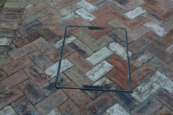

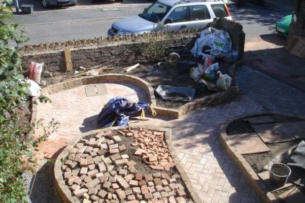

I'm making a patio and path from clay pavers. I made them from some pamments that someone gave me - not old ones but new ones, which were 300 x 300mm, and 30mm thick. I cut them into 100 x 200mm pieces, and am laying them herringbone style on compacted sub-base and sharp sand.
I reckon there is a bit too much movement to dry joint them with kiln dried sand like you would with block pavers. I could try it, but they don't interlock, so the sand might just work its way underneath them and push them up.
The joints are too small to point with lime mortar, although I will persevere and do the edges this way.
I thought of dry jointing them with a NHL / sand mix and then letting the rain set it, but I think the lime would stain the faces.
What I do have a lot of is dry sieved soil, because I have sieved all the soil in the raised beds, and it has been dry. Is it a crazy idea that I could dry joint them with earth? Would it turn to an almighty mush in the winter?
What else?........ Perhaps I should just risk it with the dry jointing. Any other ideas?
