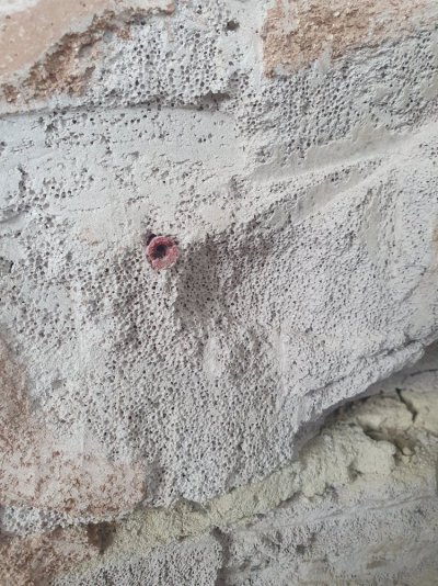

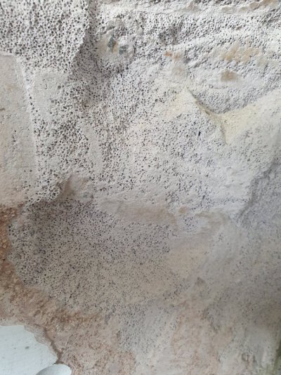

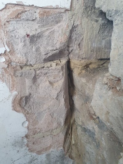

Can anybody advise if the close ups are brick/gypsum/cement or other. Im knocking behind the cooker on a 20year old extension to lime plaster. I can't workout what this is and if i should be knocking it off.
Yep agree - the last photo shows the face of the aerated concrete block on the right, as they aren’t the most robust the face is potentially being pulled off when you are removing the plaster hence you’re seeing the “moonscape” you are currently presented with.
