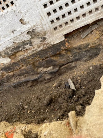

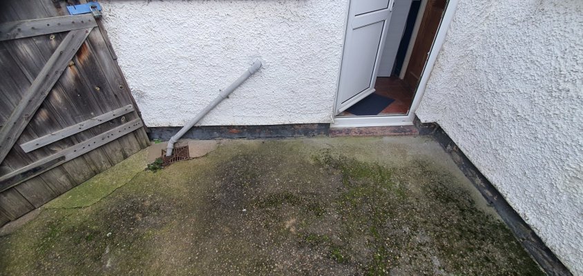

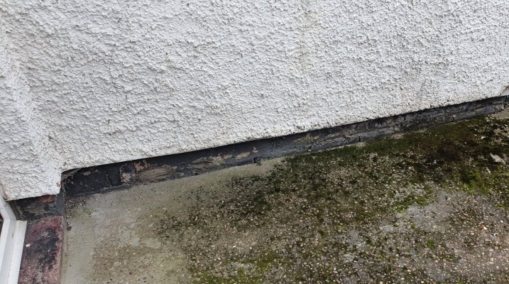

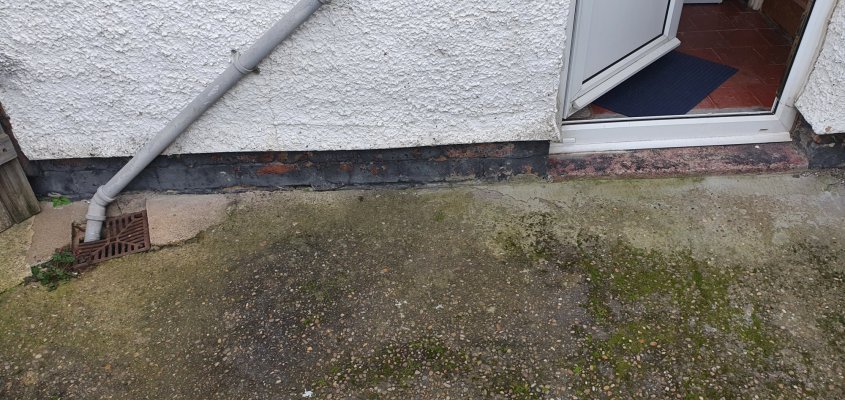

Do you mean "the inside is slightly higher" or "lower"? It looks to me as though there is a step down which,as you say, is not ideal.You're meant to 'step up' when you cross the threshold and enter your house. Looking at the photos it appears the inside is slightly higher than the outside, so not ideal. The dark stuff is bitumen paint applied to protect the wall from splashing rain.

Looking at the photos it appeared to me that the inside was slightly higher than outside but lens perspective can be deceiving. You may be right though. Either way the outside is too high.Do you mean "the inside is slightly higher" or "lower"? It looks to me as though there is a step down which,as you say, is not ideal.

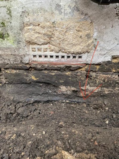

I would take an angle grinder to the concrete, remove a channel at least 8 inches wide (away from the wall) and six or more inches deep, and add a layer or pea gravel. As it is, you get splashback and so every time it rains the bottom foot or so of the wall gets wet. Rain does not splash so much off gravel.
