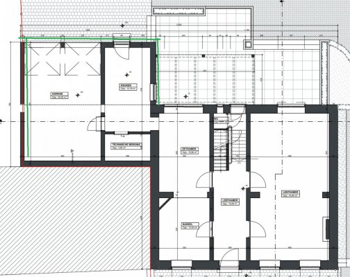

Below is an image of the situation, the green line is where we want to place wood fibre insulation. The two garage doors have been replaced by 1.
