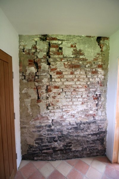

I am about to buy a cottage (old, but not listed). There is a chimney stack where the part behind the fireplace is exposed. I think that historically this may have been outside at some point a single storey extension was built such that this part is now inside of the house. The chimney then goes out of the roof.
On this interior part I have noticed some spalling. I just wanted to get opinions on what may be causing it. I have some possible theories:
1. The spalling could have been from when the full chimney stack was exposed. The dampness and freezing could have caused the weakness in the brick and it is only now it is showing;
2. I think there may be a slight leak where the roof meets the exterior part of the chimney stack. Given the room is very cold, has not been lived in for a while, and the recent freezing weather, the damage could be recent an caused by these factors;
3. At some point the current owner has done cement pointing and tried to render parts of the interior part of the chimney stack. This could be causing a problem. The spalling is now only in a small part of the interior stack so the cement render could be re-directing the moisture (?).
I'm fairly confident that it is not due to movement as the spalling is in a small area and there are no other signs of structural issues.
I'm thinking that the best course of action would be to (i) check the roof and stack and real with any potential leaks; (ii) remove the cement render and pointing; (iii) replace the badly damaged bricks using a lime mortar, and (iv) re-point the chimney stack with a lime mortar to aid moisture evaporation.
Any idea or advice would be appreciated.
