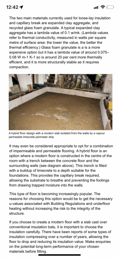

Would love to do with glass insulation & LimeCrete is it worth the expense(€12kfor materials without labour) & the effort ?

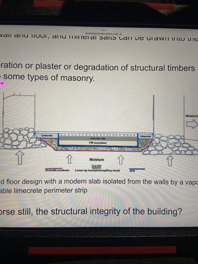

Nhl5 is it breathable enough especially when there will be another layer of tiles etc ! Could I do some sort of hybrid floors but how would you install the UFH PIPING where concrete would meet limecrete & the labour involved shuttering out floors
Or could I use some sort of insulation to keep off wall & use concrete , please help
