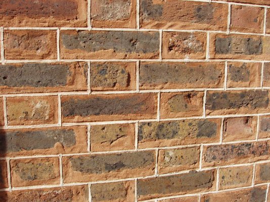

Currently repointing a 1905 / 1910 London terraced house. Mostly likely solid brick wall.

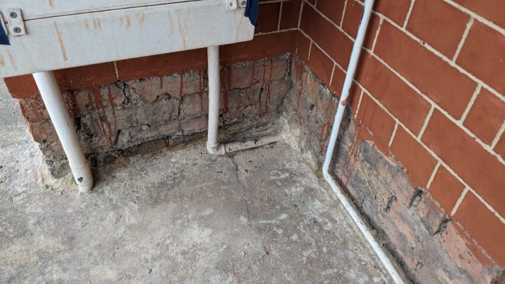

In the process the rendered plinth at the bottom has been removed (it was blown). This revealed the DPC which seems to be some sort of TAR spread above a course of bricks. The plinth was bridging the DPC hence probably why it was swollen / blown.
The ground is surfaced with concrete going all the way to the front brick wall of the house. The ground stops at about 2 inches below the DPC. We're aware that ideally it should be lower (about 6 inches).
We are not trying to solve a damp problem, only to do things the right way, with respect for period features and appropriate building methods, and without creating issues. There is no issue at the moment and no sign of damp on the inside walls / skirtings although we have not been able to check under the floor (no intention to replace the floor now, could take a look with a snake camera via the air brick I suppose).
