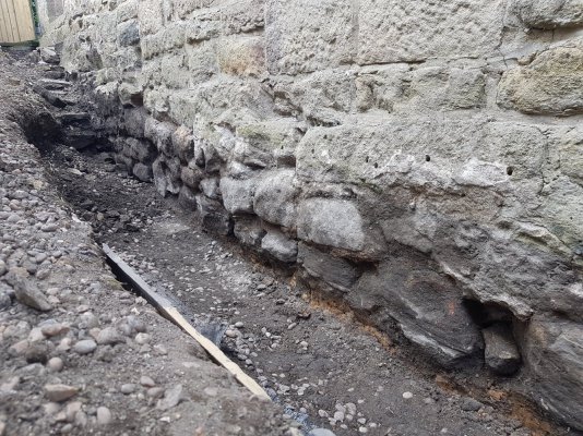

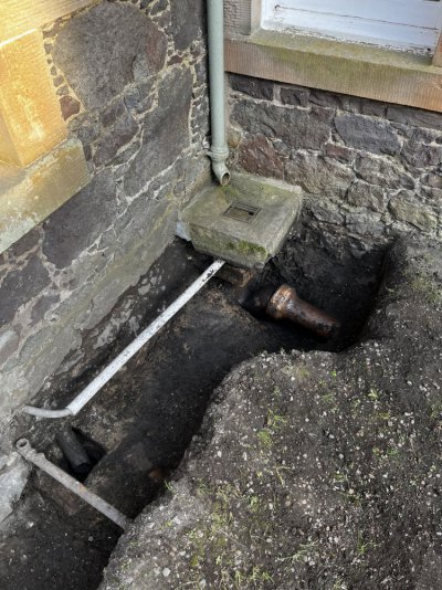

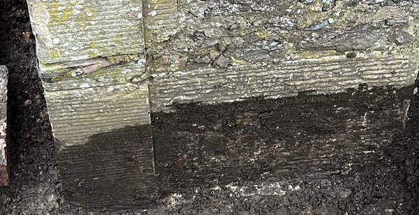

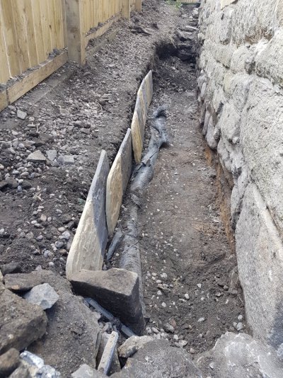

So, on a mission to get our 17th c house breathing again after moving in 3 weeks ago.
Had some water marks showing on the stone fireplace on external wall.
Internal floor was lower than outside but it's around level with external side after I've dug out a trench. House appears to be built direct on clay. Earth was covering the stone wall up 1 meter above internal floor level in some places and with weeds etc growing up against the wall.
A drain pipe has been put in and laid in gravel to the side but assume that's to direct water from the rear which is significantly higher on the front.
Someone in the past has gone mad with injected DPC but they look to have been removed / drilled out already.
Inside has a vile 1" thick concrete floor which looks to have been laid over yorkstone flags. Luckily the rest of the G/F has its flags laid to earth.
Question? Would the previous "higher" ground level before I dug it out been as it was when built i.e backfilled or is it likely that earth has built up?
Would it be wise to leave at the level it is now and gravel the ditch I've dug, repoint in lime to let it breath?
